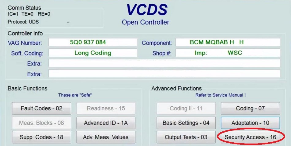

ALLER DANS CENTRAL ELECTRIC

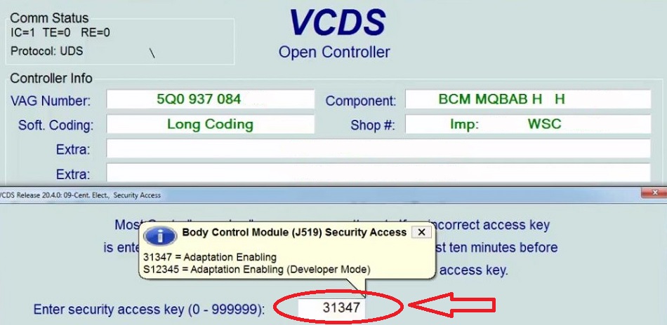

SECURITÉ
NOTER LE CODE DE SÉCURITÉ 31347 PUIS VALIDÉ

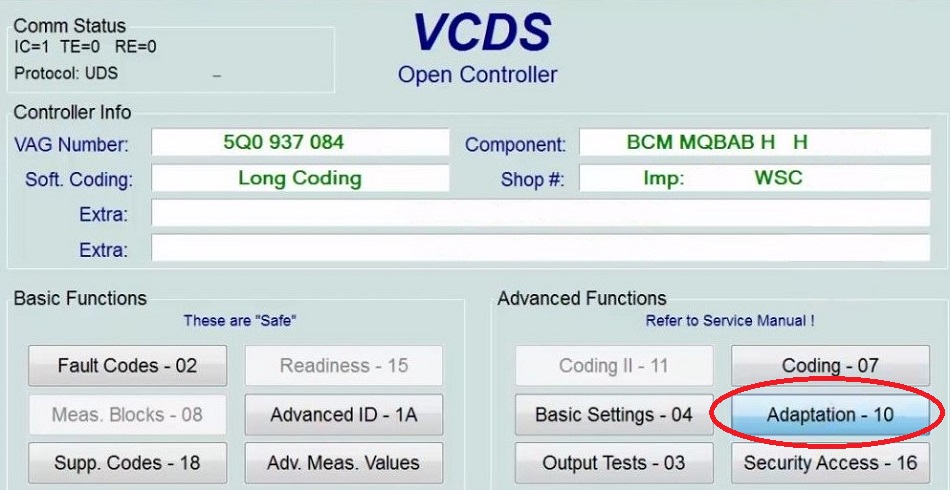

ADAPTATION

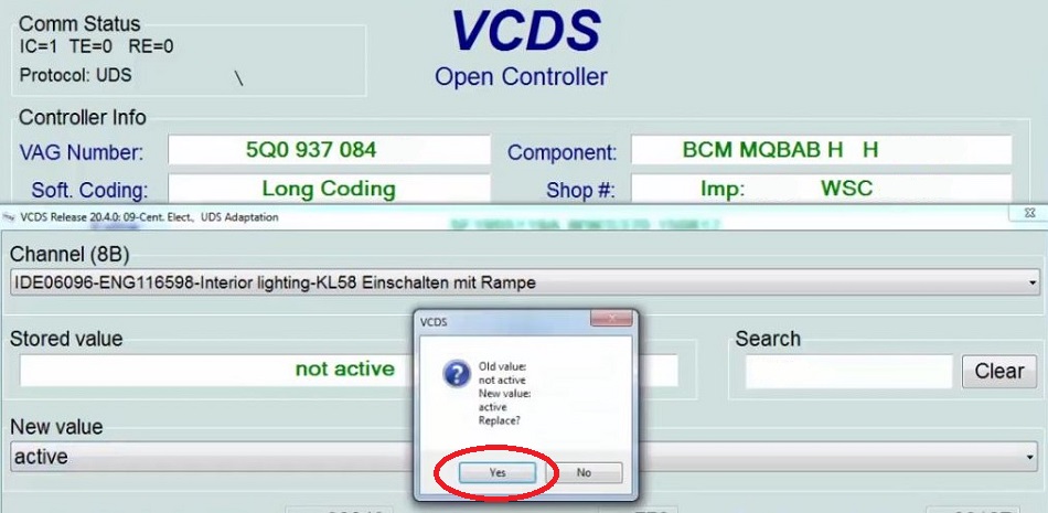

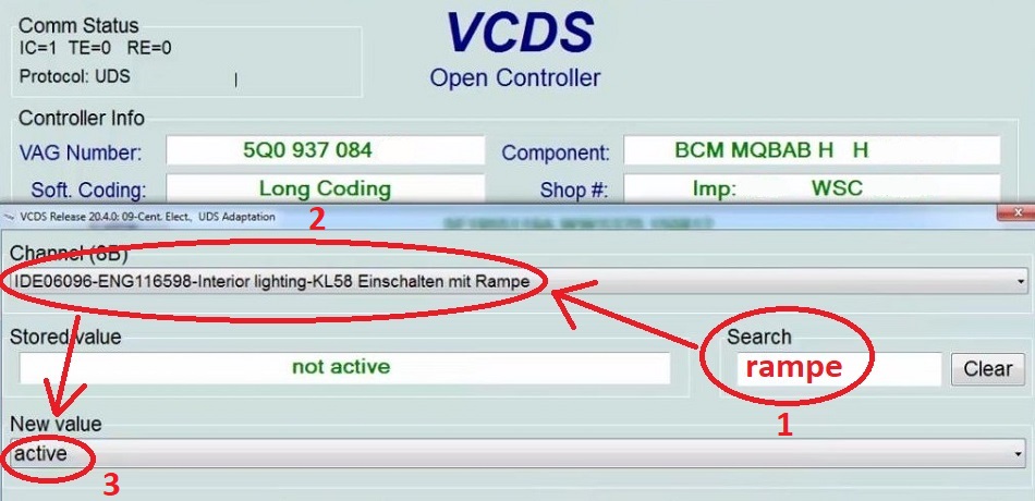

1: NOTER "RAMPE" DANS SEARCH
2: cherchez et cliquer sur: interior lighting-KL58 Einschalten mit Rampe
3: activer
POUR TERMINER "VALIDER"
